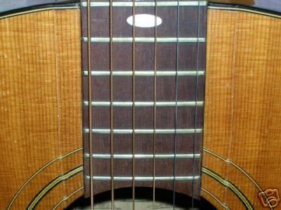

This guitar is for sale on ebay. Its reported to be luthier built from 1989. Looks like it's not holding up so well. I've never seen movement this sever.

Looks like the rosette is the only thing holding it together! Should I bid?

Not that Frank couldnt have fixed it even it was worse, but notice how the break line is right down the edge of the pearl inlay - very convenient - the only spot to see the repair otherwise is the spruce around the rosette rings. Well done Master.
A friend who owns a shop has a selmer copy large D hole - and the top has split similarly, but on the bridge side - and I swear the rosette is all that holds the whole top together !!!
To fix that guitar you will need to get a spreader brace inside and push the neck block back to where it belongs, then fix the cracking sections.
